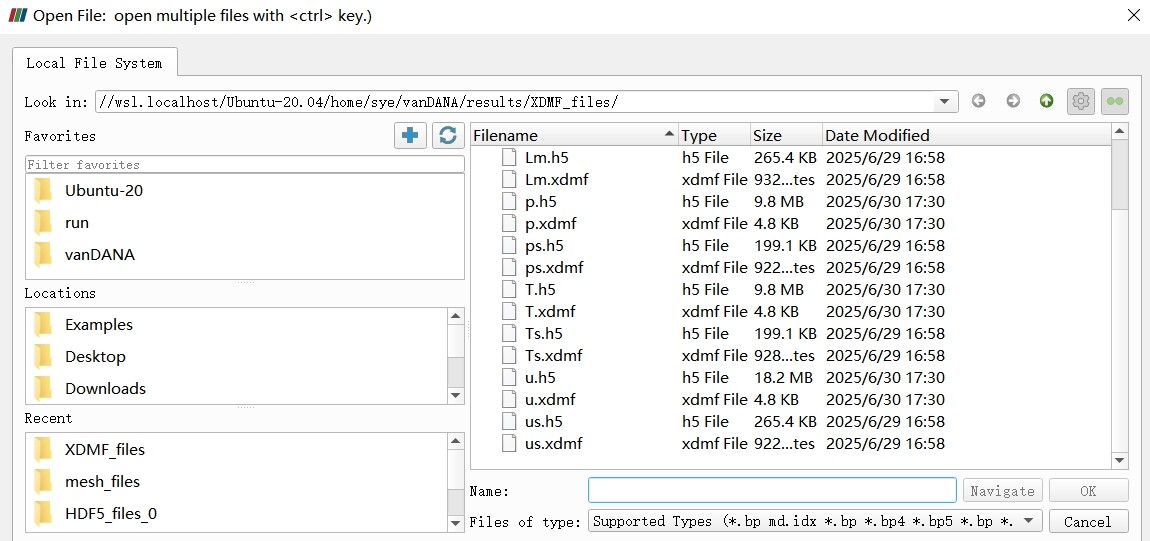

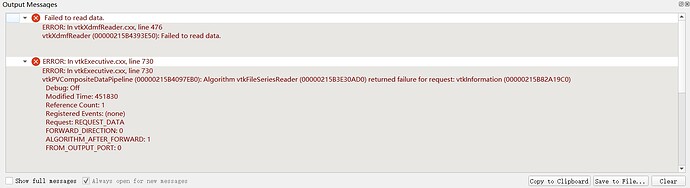

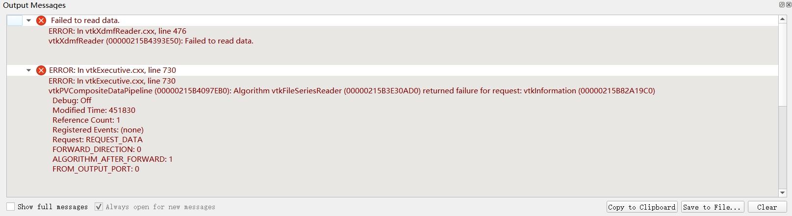

Thank you for your reply. It’s the same error.When I open the T.xdmf file in the paraview and select XDMF Reader, I get an error, and using Xdmf3 ReaderS/T is a direct crash.
Hi @yien-sudo
Have you manually modified the name of the files by any chance?
Also I see that your XDMF files are in WSL. Is paraview installed in Windows or in WSL?
First of all, thank you very much. I did install the paraview to the D drive. According to your reminder, I moved the XDMF_files to the E drive and opened it successfully. I found a CFD solver vanDANA in GitHub and installed and ran it under Ubuntu wsl, how do you see such an error?
