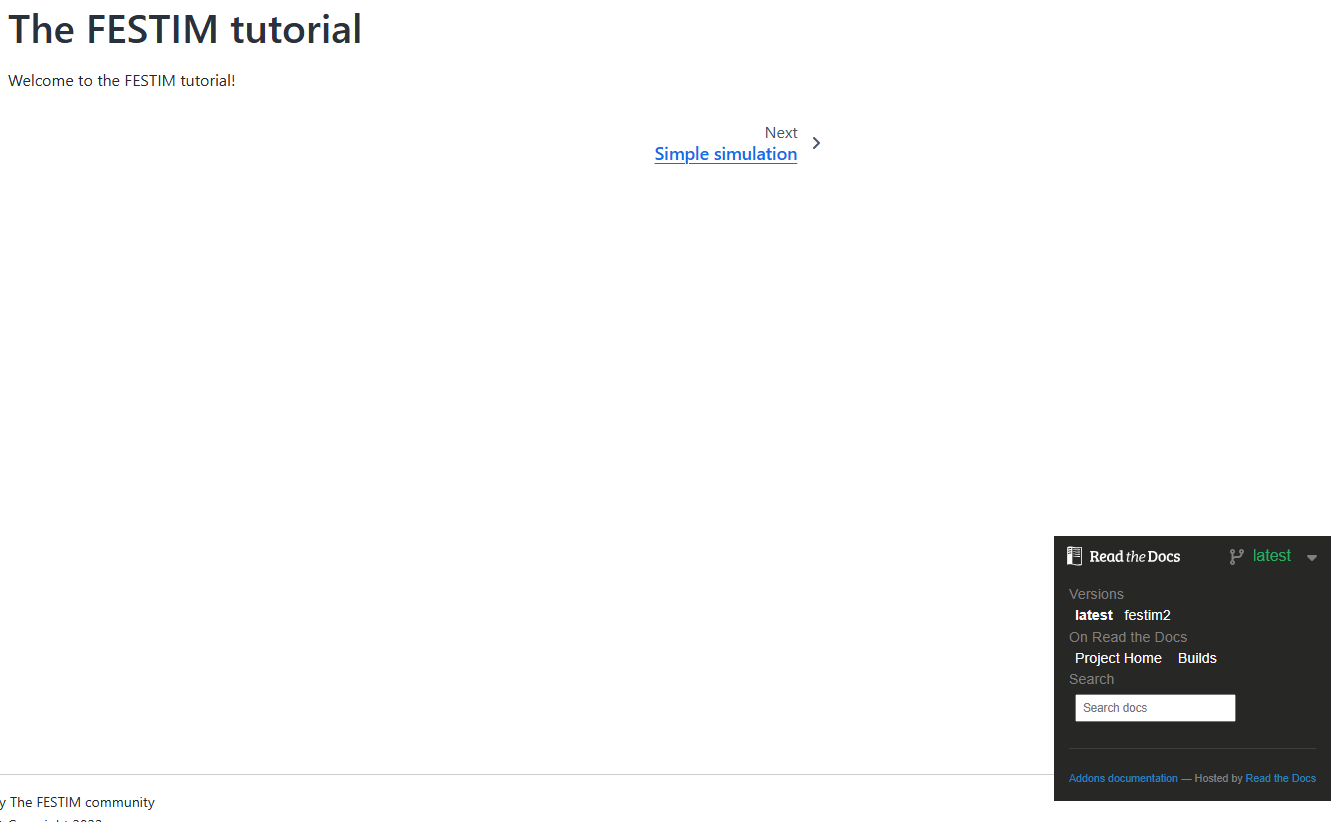

FESTIM 2.0a3 indeed does not have the Simulation class. For this alpha-version, you might want to check the corresponding API reference page of the documentation. Moreover, the Workshop is being updated to follow the new version. In general, you can choose an appropriate version of docs/workshop in the Read the Docs menu usually located in the lower right corner.
Screenshot

Meanwhile, I managed to sucessfully install FESTIM 1.4 from scratch following the FESTIM installation instructions. Would you mind showing the list of installed dependecies with conda list and the conda version conda -V?

regarding this MPI warning, i can’t say I’ve already seen it. But you may want to delete this environment and start fresh and see if that solves it.
Also
  • Did you notice the workshop has now been converted to a website?
  • For running all the tasks, you will need additional dependencies (eg. matplotlib, scipy, etc.). You can install them all using this environment file in the workshop repository then run:
conda env create -f environment.yml
